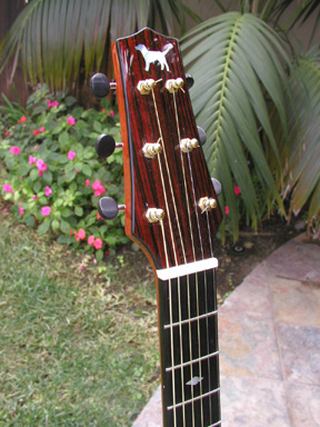

I like the string pull to be pretty straight. That is why I have moved to more of the snakehead design.
Also. If you are using Waverly's you need to space them a bit differently than the closed tuners. They are slighly larger and require the posts to be a little farther apart.
